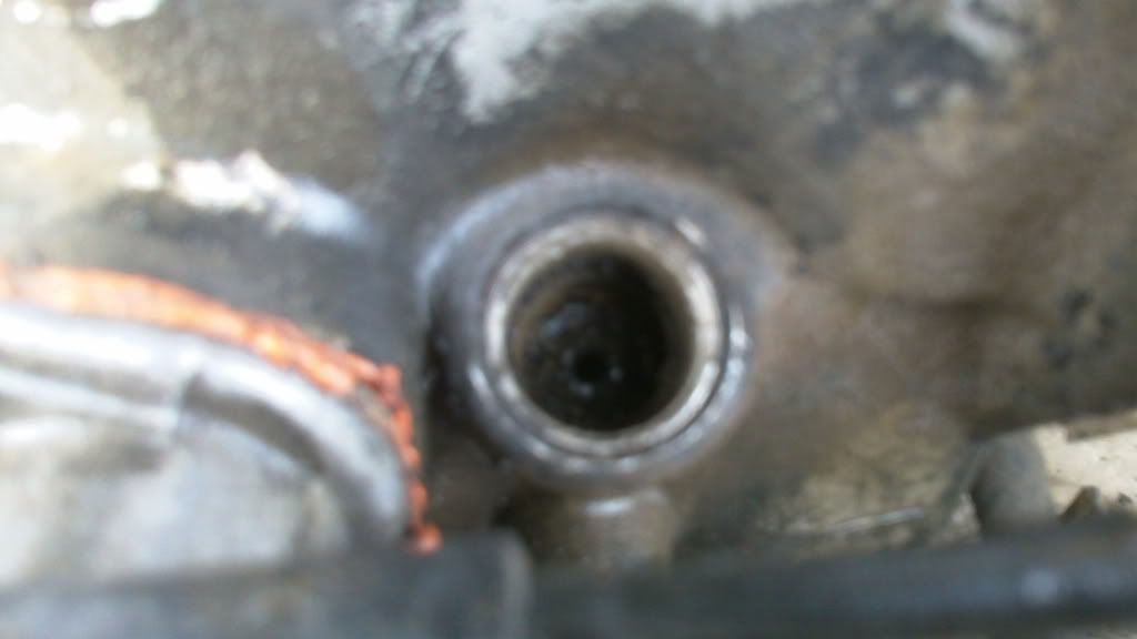

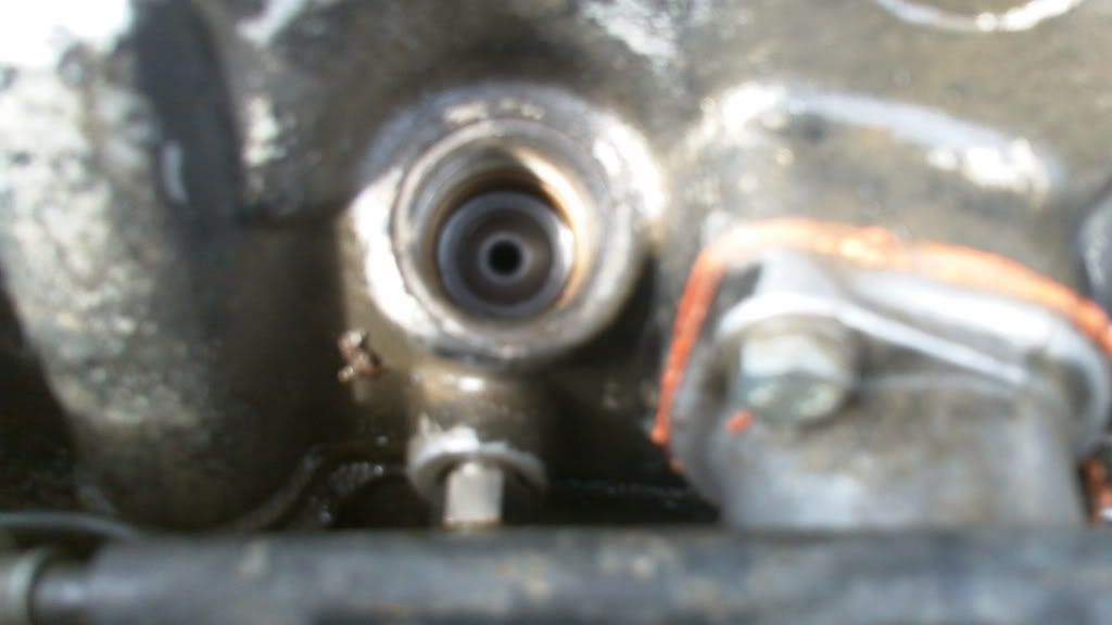

got injectors out. took them apart and cleaned them with a solvent. but i found the culprit I think
clean injection port
dirty dirty injection port.
any tips on how to clean it out with out taking apart the engine??
Re: happy 30th rabbit!
Post by Roadhog » Mar Thu 24, 2011 9:41 pm
I bet if you pull the washer thing out and clean it, it will be pretty clean.
Post by t-dubbin » Mar Thu 24, 2011 10:47 pm
its stuck in there :-/ gonna let senior wd do some work overnight

Post by t-dubbin » Apr Fri 01, 2011 9:27 pm
a little cleaning and its alive!!!!!! i did some math and i have to drive it 2500 miles instead of my xterra for it to pay for itself. so stoked
