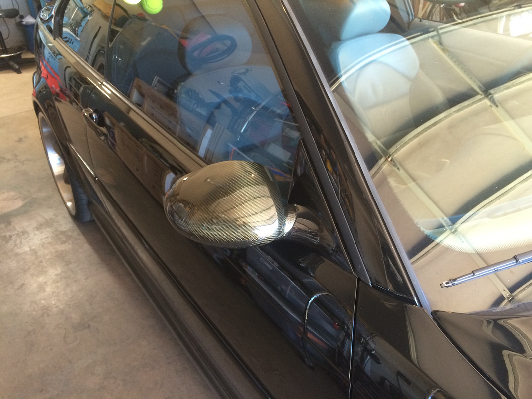

Anyways, diving right in, there's a few items that need to be addressed. First is the mirror covers. To each their own but I'm not digging the carbon fiber mirror covers so those have to go.

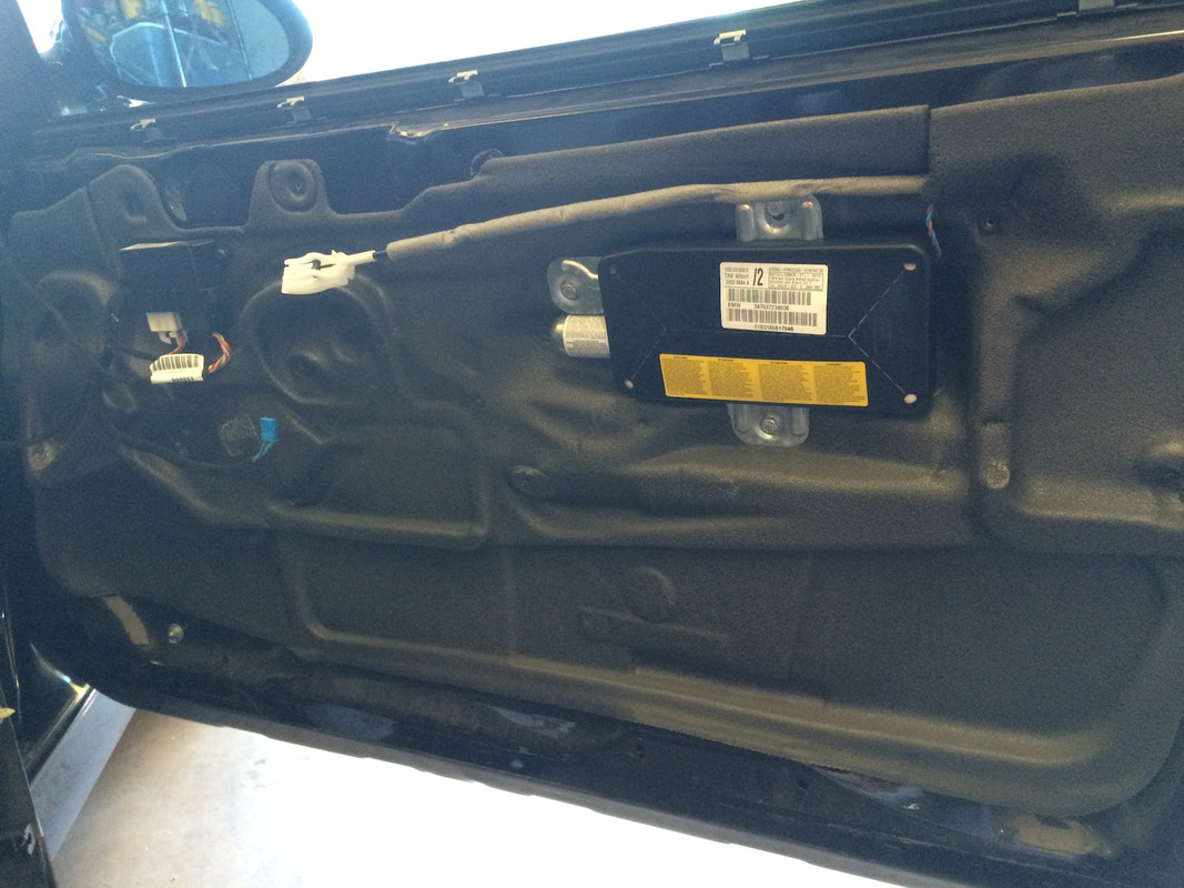

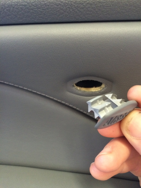

Theres 5 screws holding the door cards on. Three in the usual spots in the arm rests, 1 in the usual behind the door open lever and one hidden one that had me stumped for a bit behind the "ABS" badge.
Unlike Toyota and Subaru, once the screws and clips are released, the panels don't slide up, but instead you pull them in, toward you to release the clips.

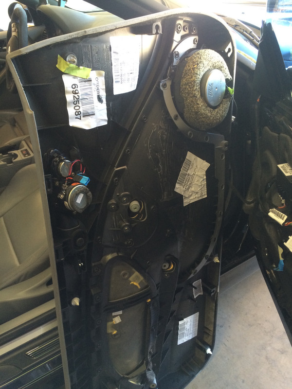

With that done, you can disconnect the tweeter wire and the door release cable and set the door panel up
If you remember from my MK4 thread rattles drive me bat sh*t crazy so very happy to see this. Not just a vapor barrier but some foam for sound and rattle. Even the wires are wrapped in soft fabric/foam to keep them quiet.

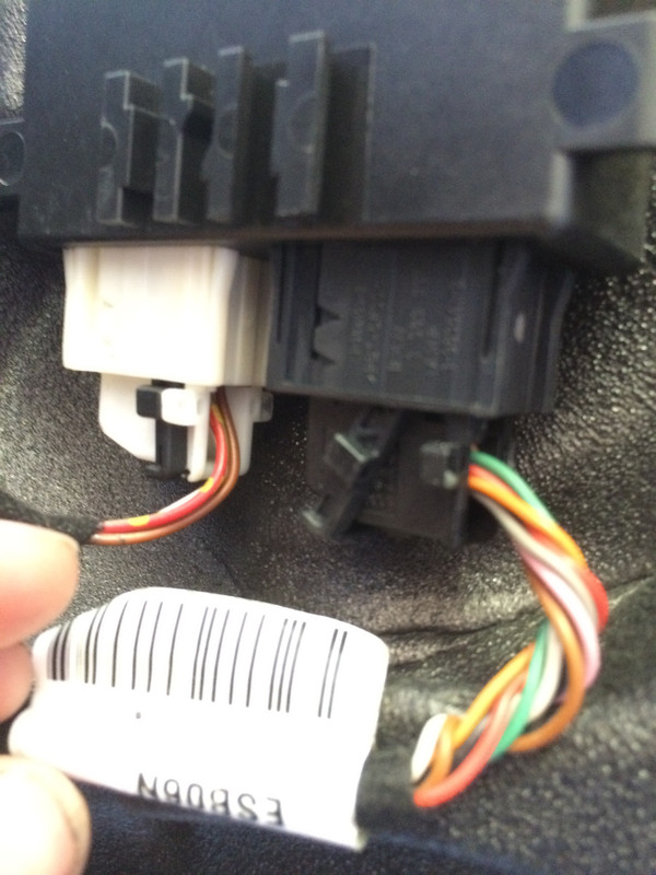

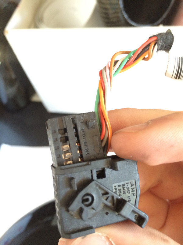

These connectors always make me happy. Not sure why

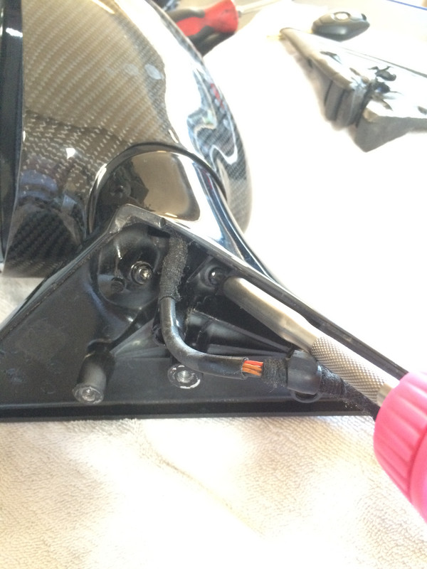

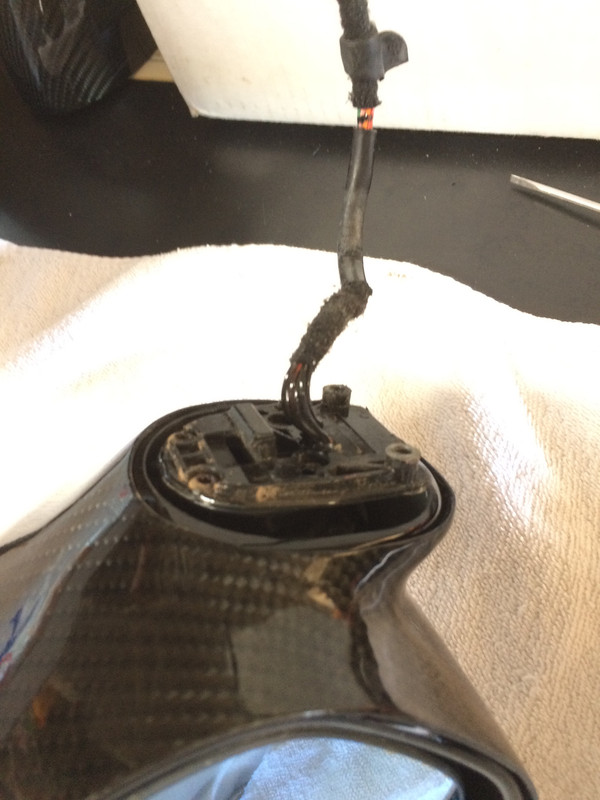

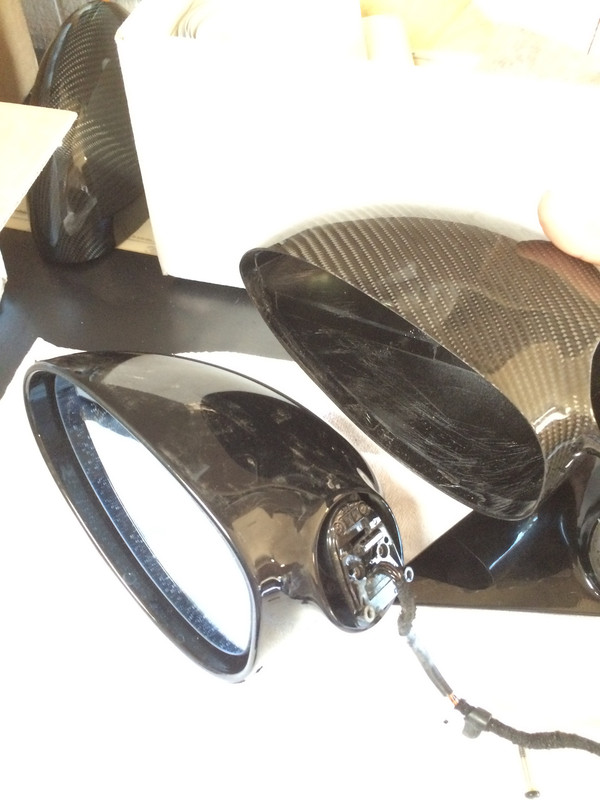

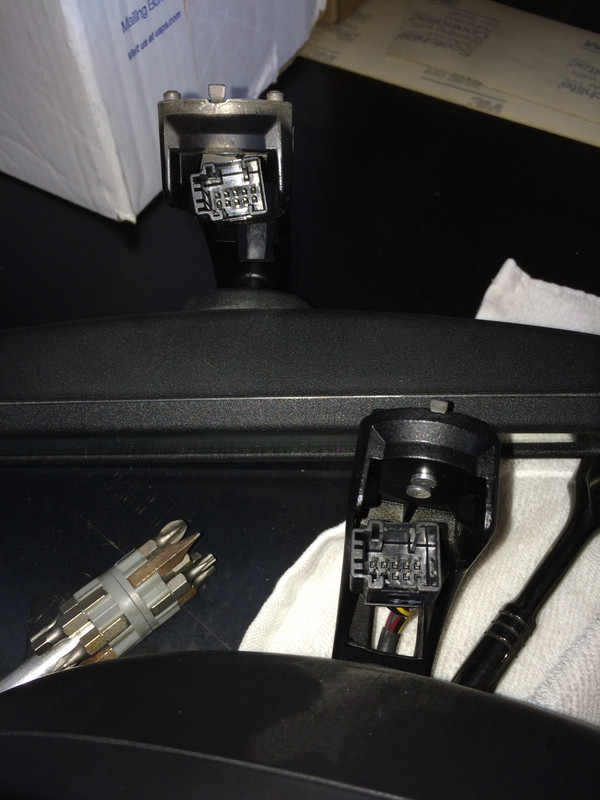

Couple of 10mm and the mirror is off. Take out these two screws and you can separate the mirror body from the mounting plate.

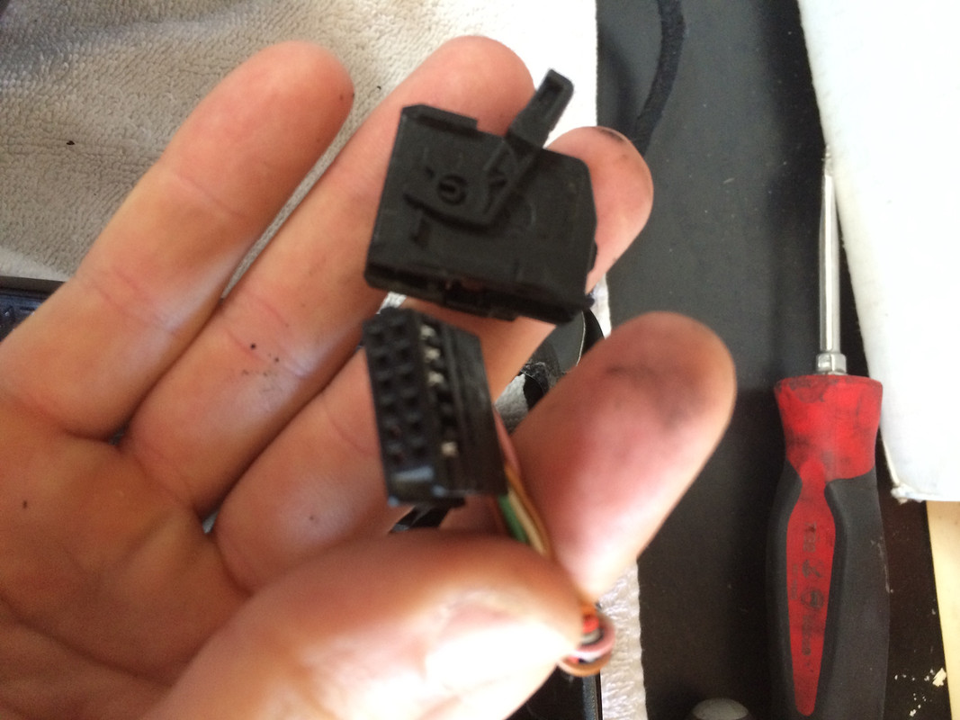

Ah, ha. When I did the DS I didn't realize this connector came apart so I disassembled the mirror glass, body, motor to disconnect the harness from inside the mirror in order to get the cover off. Today doing the PS brilliance struck. By doing this, the connector is now small enough to fit through all the holes saving much-o time.
And tada
Oh, thank you engineer would put an arrow telling me which direction to assemble this again. Ha!

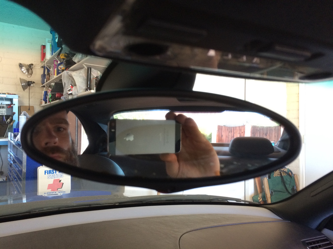

Next is the rear view mirror. Three things here that bother me.
  • Size. The little oval is hard to see in
  • Mirror is starting to tarnish
  • Does not have homelink which is for opening your garage door

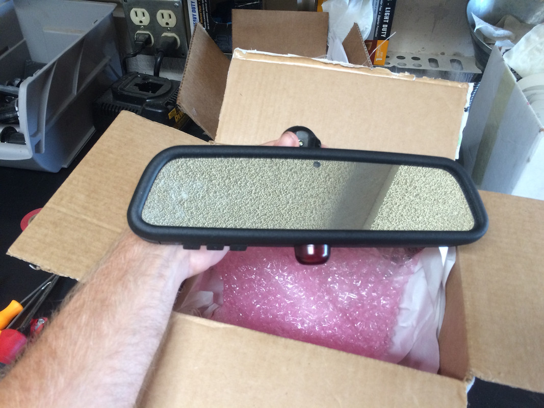

Doing some googling and part number searching on RealOEM I found that you can replace with both a traditional size and one with homelink. Sweet! 60$ and two days later one from Ebay was on my door step; Lets get this puppy installed.

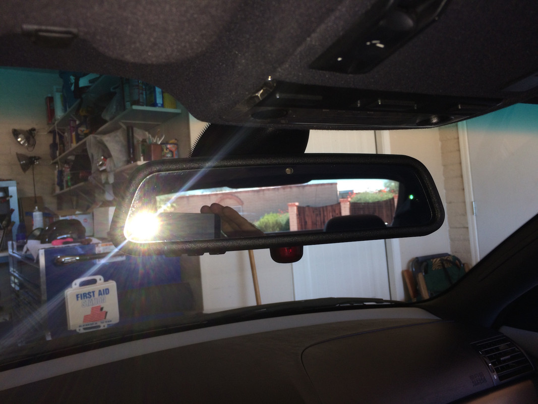

First, the current mirror. It's hard to take photos of mirrors. Meh.

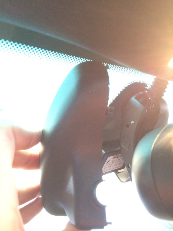

Remove the wire baffle. No drama, just push up on it which kinda bellows it out and all the clips release.

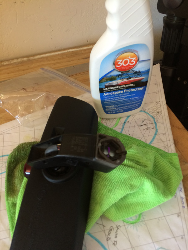

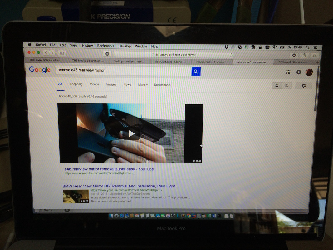

Hit up youtube for how to remove the mirror. It's not the traditional slide up and off type. Ah, it's twist. Ok. I bet that before the internet more pieces were broken during disassembly :nod:

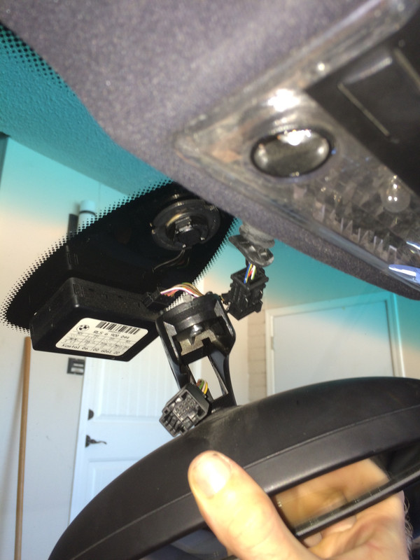

Sure enough, super easy. The other sensor you see under there is the rain sensor.
Comparing the connectors, and yes, same.
Since it's off it'll be easy to put some 303 on it
And I'm done.

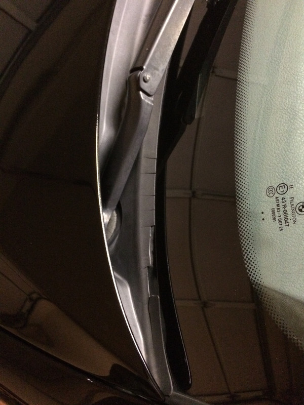

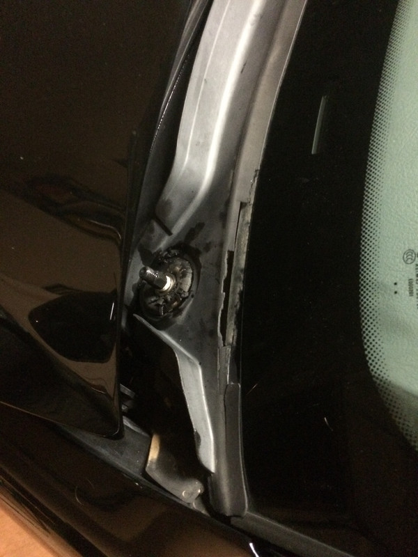

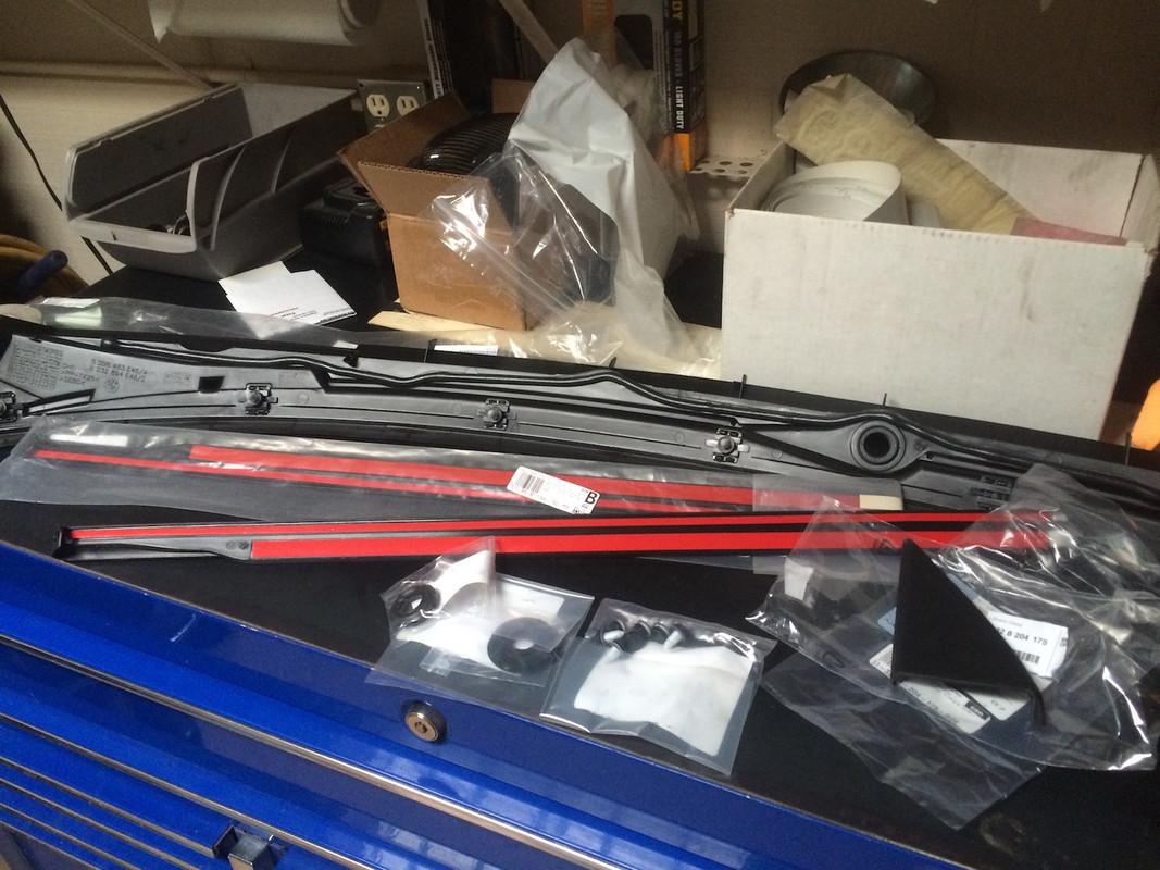

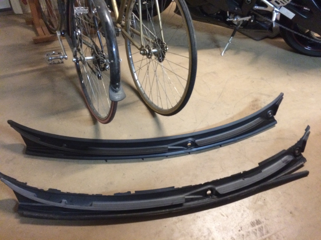

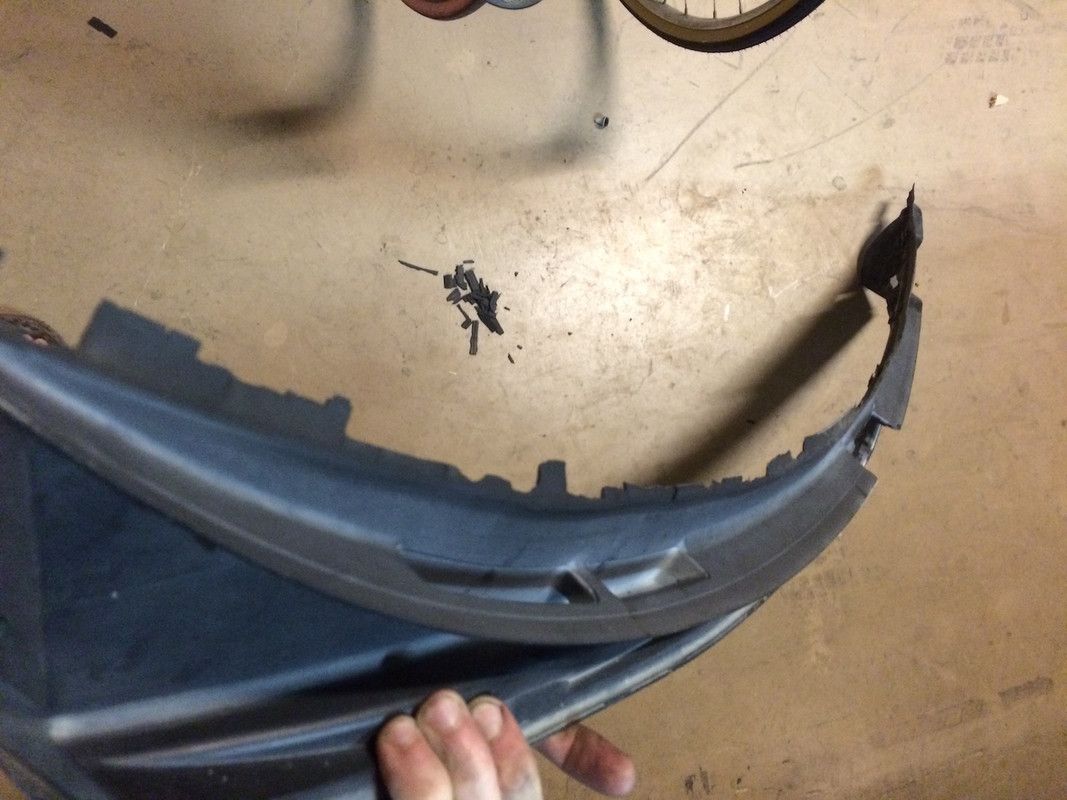

Windshield trim piece was all dry rotted. Replaced. 60 bucks well spent.

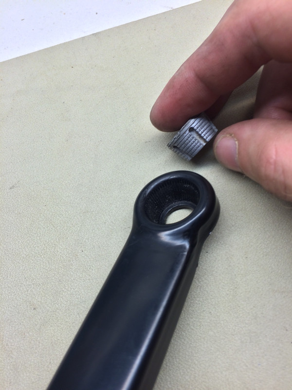

No tapered wiper shaft. This uses a conical wedge.
New and old. Just checking that they're same.
Old one. By--eeee

Post by MT-Getto » Sep Wed 21, 2016 10:01 pm
That plastic is toast!!
Looks like you need some air in that motorcycle tire too.

Just an illusion since the bike is leaning toward the camera.
