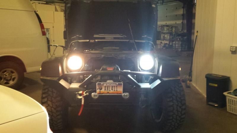

Post by padroB5 » Jan Mon 12, 2015 11:31 pm
Renn can you post a picture of kit you are talking about so I can see the size of the led / bulb . I can really see the difference in the picture with the jeep. I have looked at some kits on line for about 70ish non China brand lol. Thanks for the input it's greatly apreaseated.

The pen and AA battery are for reference only. They are not, I repeat not for sale. They are mine#
