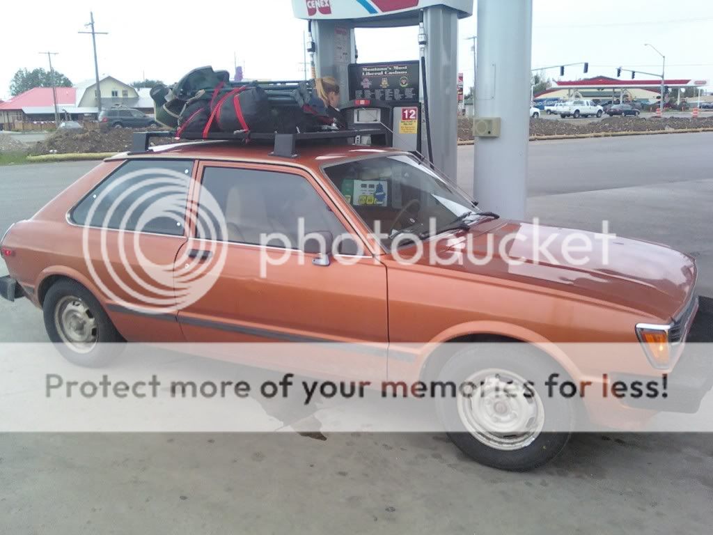

We loaded up the Peanut and were heading up to Eureka,MT for a camp trip. All our gear, food, drink, and dogs. We were heading up the pass toward Butte and started smelling oil burning. Got to the other side, checked the oil level. Almost empty. The head gasket blew. Oil coming out of the side of the head and probably into at least one of the cylinders. Burned through 3/4 of a gallon limping it back to Belgrade. I'm pulling the head later today and seeing what is up. :banghead:

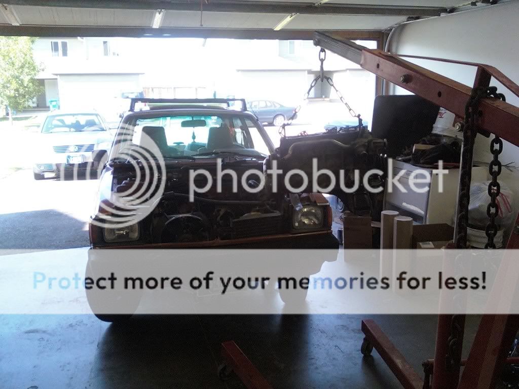

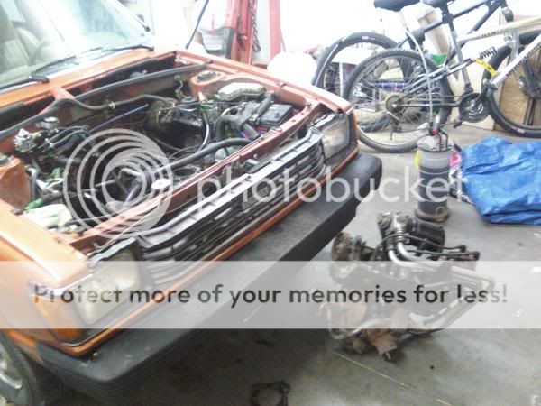

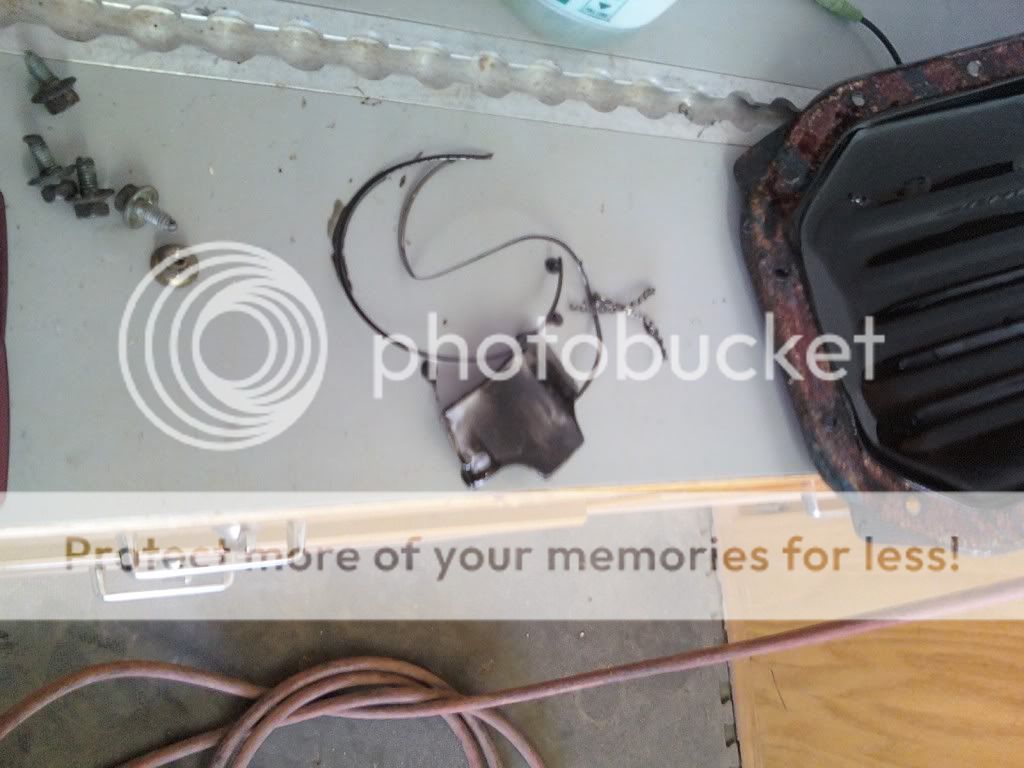

Postby Mrbubblehead on Aug Sat 11, 2012 9:44 pm
Got the rest of the motor out... I felt some unusual play with piston #3. Bore measured fine. In the oil pan I found a piston skirt and what was left of the oil ring. They belonged to piston #3. When I get a chance I'll measure it up before rebuilding it.

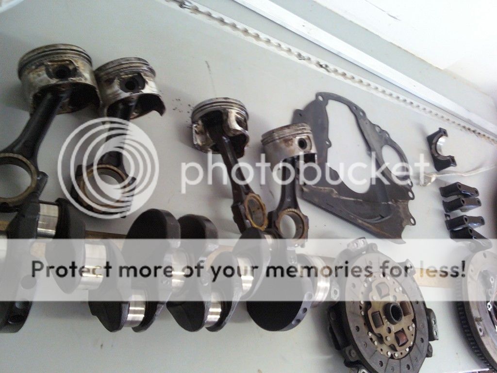

Postby Mrbubblehead on Sep Sun 09, 2012 7:17 am
Everything measured out and is getting machined. Head is decked and I should have it done tonight. Crank is getting polished, block is getting punched .020" over, and flywheel is getting resurfaced. Here's a pic of the rest of the piston.
