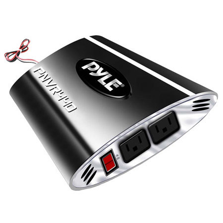

It just started snowing here in Kali. Im wondering if I should reassemble the heater core back into my car or look for an electric heater for warmth and defrost, I don't want a cheap 12V fan tho I might have to for now, any Ideas? Also the wiper fluid is gone now too but Im going to try to mount it in the trunk and use the existing pluming. Anyone done this? I've seen a couple forums I think.

Postby padroB5 on Nov Thu 08, 2012 5:27 pm
well there is a heater made by kates thats a 900 watt which is pretty warm. you can go to carquest an get one. line code is HTR the part number is 78037 an i dont know if they have one but i know they can order one for you. thats what i got out of my books to hopefully help.
Re: Digifant mk2, no spark
Postby idubse7en on Nov Thu 08, 2012 9:12 pm
padroB5 wrote:well there is a heater made by kates thats a 900 watt which is pretty warm. you can go to carquest an get one. line code is HTR the part number is 78037 an i dont know if they have one but i know they can order one for you. thats what i got out of my books to hopefully help.
Might give it a try with this:
