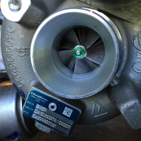

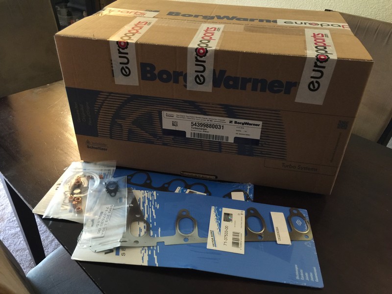

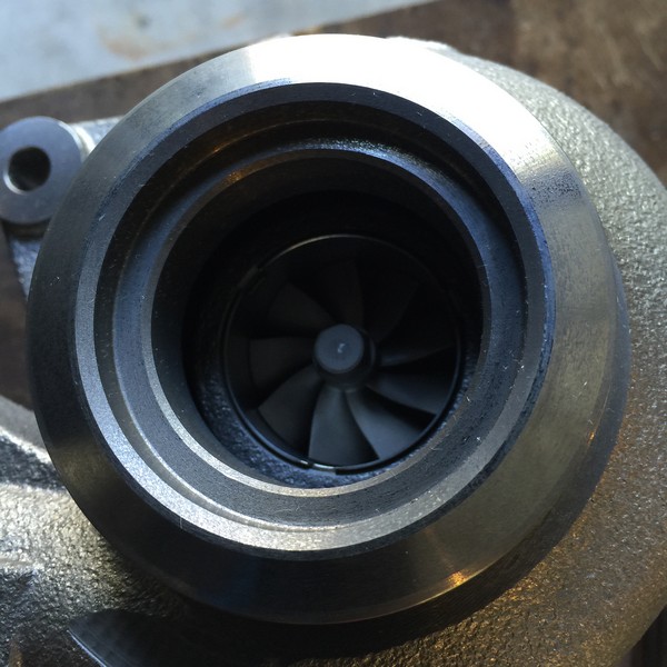

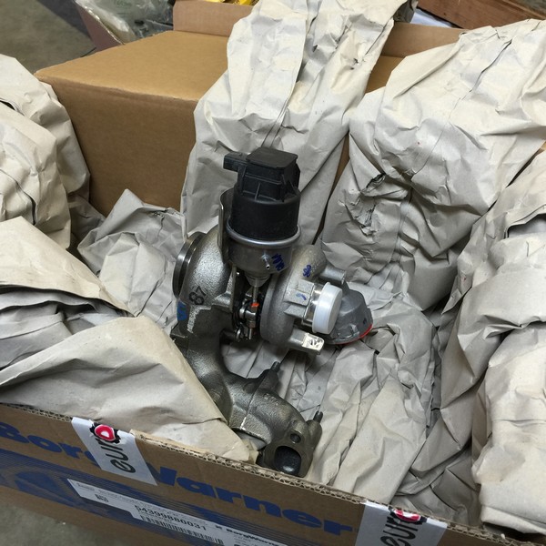

Quick update on this - redneck compression test sounded decent, so I ended up picking up a new turbo from Europa Parts.
Yeah it's a risk, but I figured I'd give it a shot, and bolted the turbo up...fired right up. Sounds good, has good power, and I may have gotten lucky on this one. It cleaned up well and should be decent to drive around.
