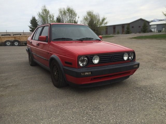

Getting ready for some track torture, so I did an oil change today at 163,000. I've been driving this swap for 3 years and 10,000 miles!! No major issues to speak of. :thumbsup: :beer:
This stuff cant hurt either:

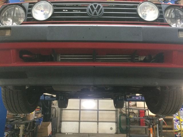

Dirty car with holes in bumper and crooked intercooler passed required pre-event tech inspection by qualified shop:

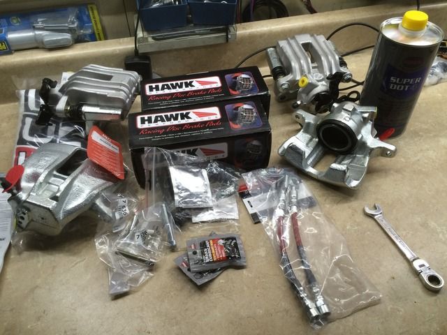

Postby SweaterVest on May Sun 22, 2016 2:23 am
Man I love that car! Upgrading brakes or just replacing calipers and such? Super dot4? Somehow better than normal dot4 but doesn't meet the standards to be called dot5 or something?
Posts: 606
Re: 20VTMK2GLI
Postby MT-Getto on May Sun 22, 2016 6:51 am
Stock front brakes on the GLI 10.1" rotors, and MK4 rears. Can't hurt. Seems like my rears have been dragging so I figured I'd replace them all. Not sure why super4. They don't sell the super blue racing any more so this is the replacement. Its not blue, and there's no racecar or checkered flag on the bottle :(
