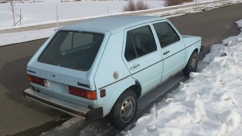

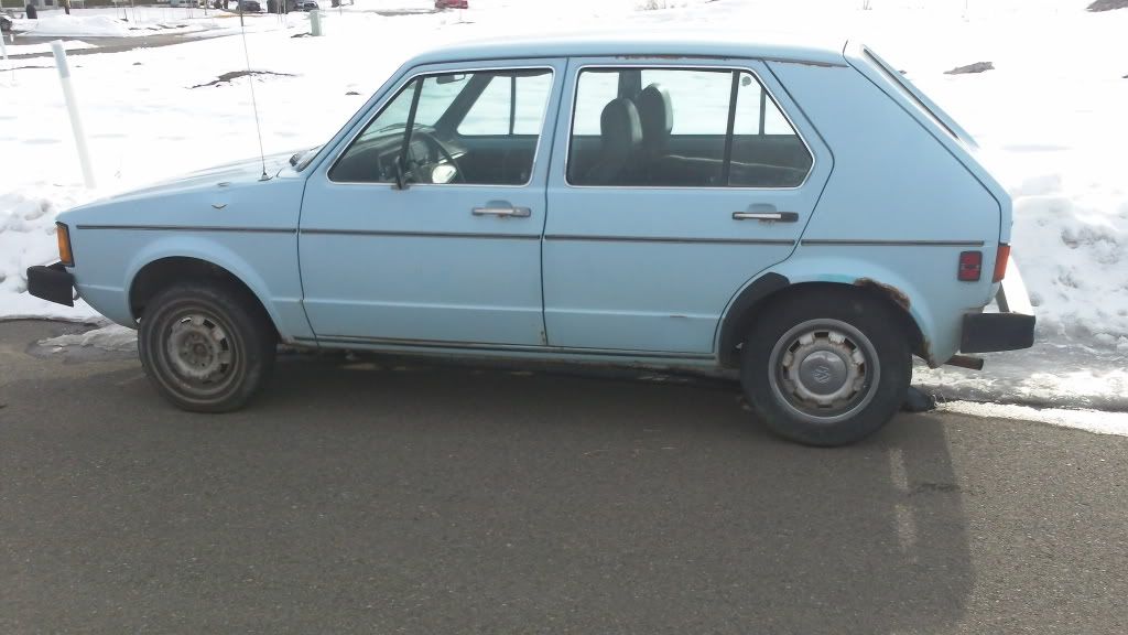

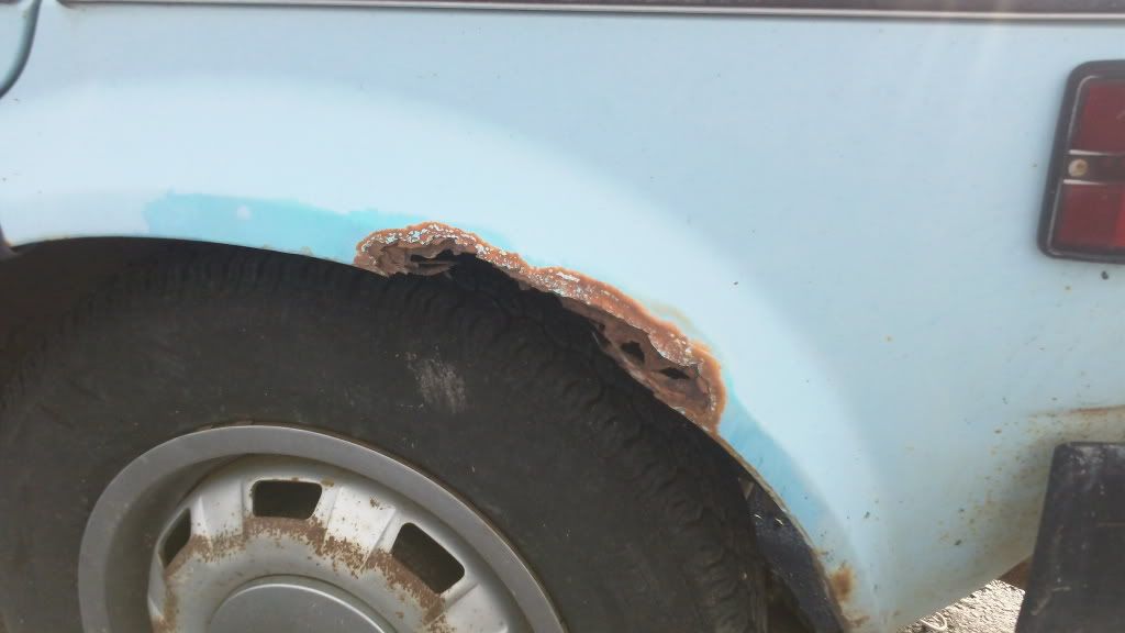

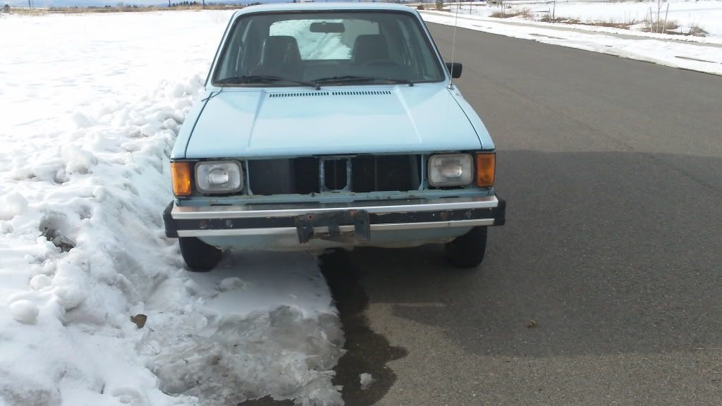

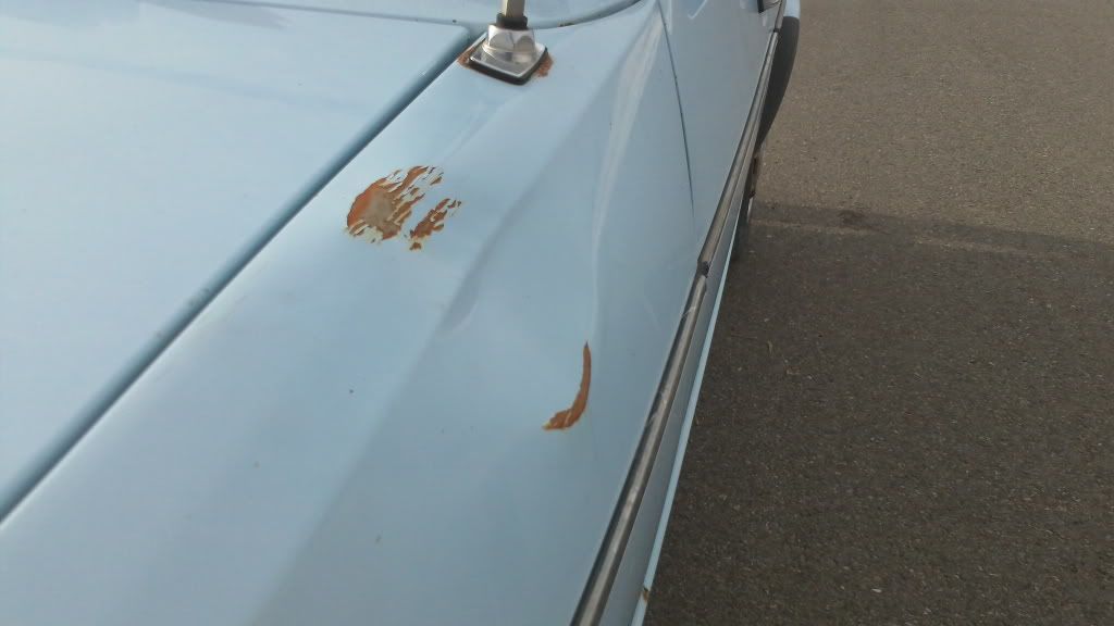

1981 diesel rabbit! picked it up on saturday! planning on making it a nice daily driver/ road tripper. hopefully will start diagnosing why it wont start this weekend. ImageImageImageImageImage
not to bad for 30 years old and only that little bit of rot... and 1 dent. happy birthyear rabbit :)
