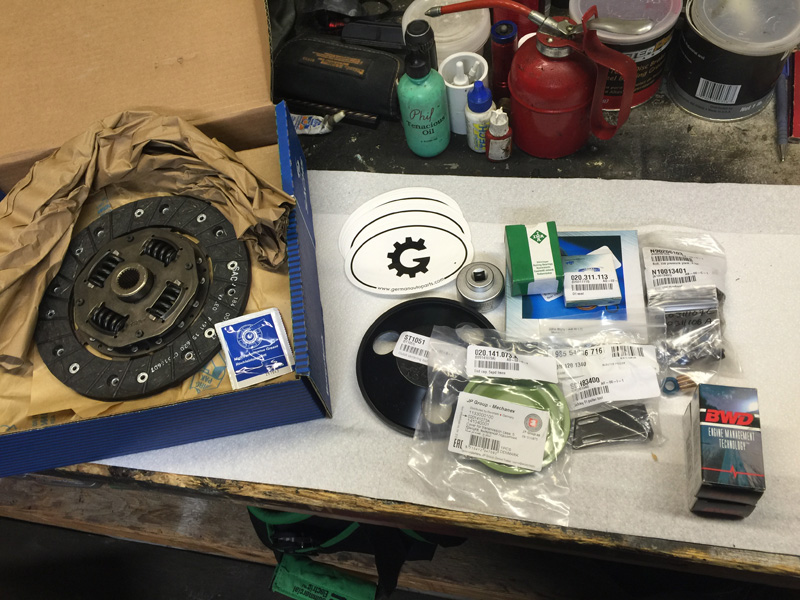

With another project looming closer, it's time to get this Caddy up to par. Clutch, kit and injector seals are on the bench and ready to install.
No pictures of the injector seals...those are pretty straightforward and swapped out pretty quickly.
Time to dig into the clutch.

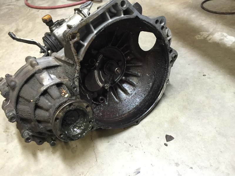

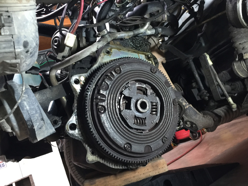

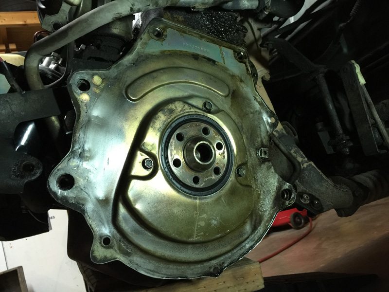

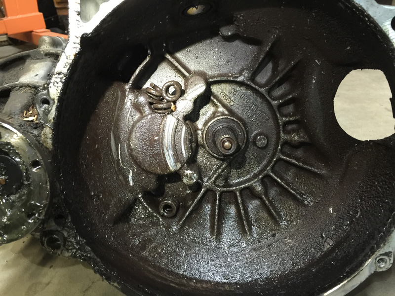

Transmission pulled...what's all the metal in the bell housing??

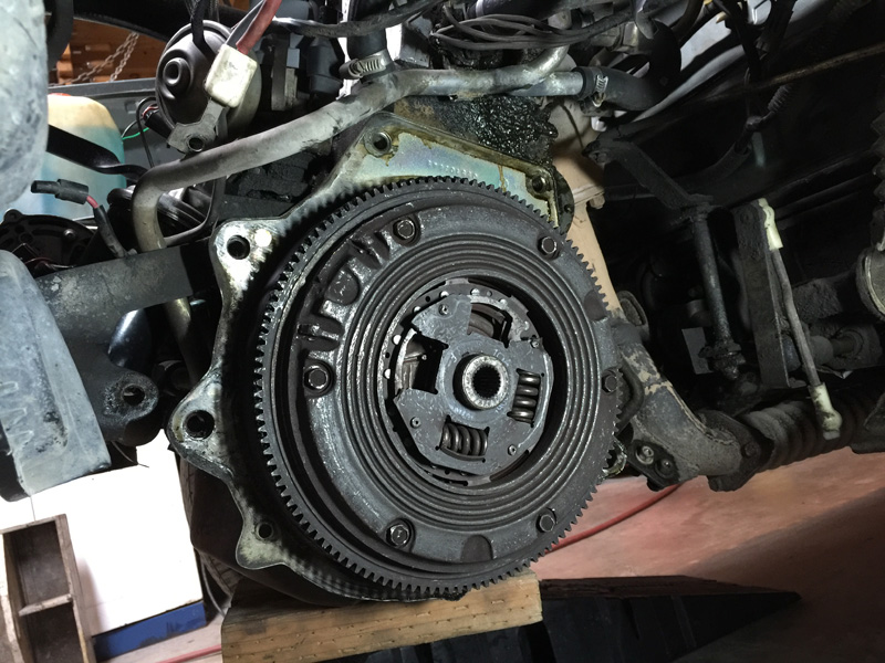

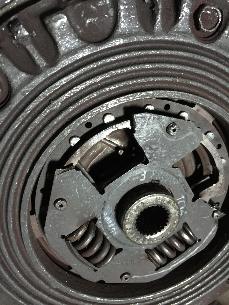

Hmm, broken clutch disc :thumbsdown:

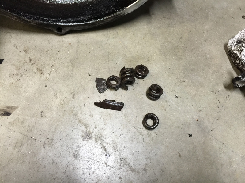

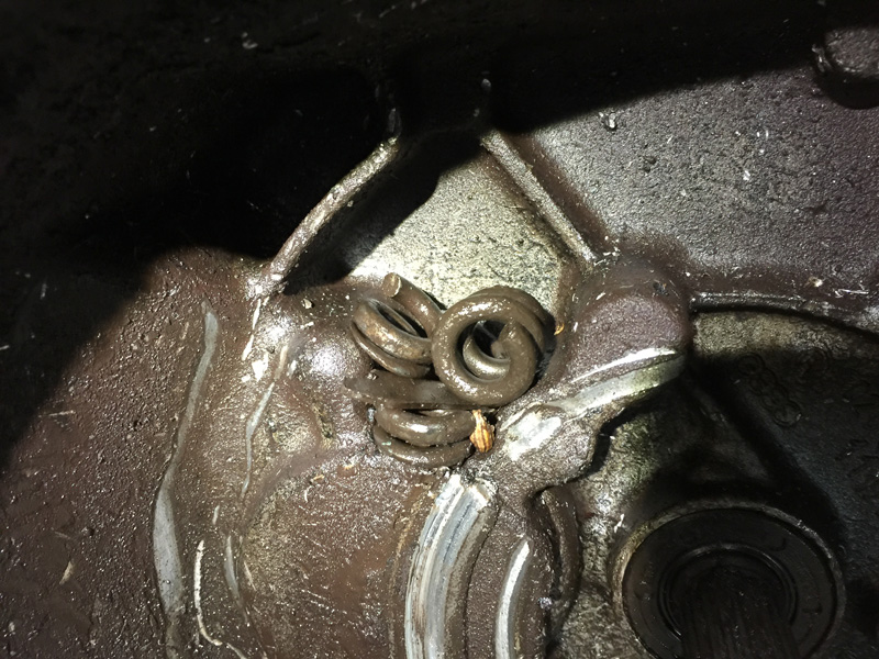

So, where did all that end up?
Here it is...lol :nod:
