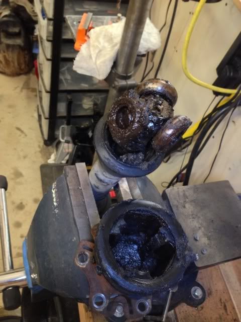

Well then..... suspicions were correct. Inside CV toast.
Took about an hour to swap out with one I had on the shelf. Gonna test drive after I clean up a little.

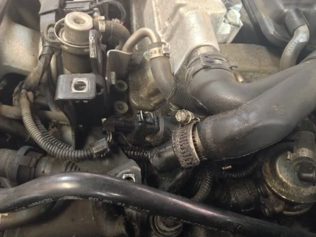

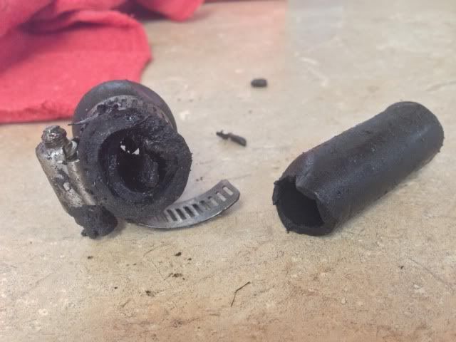

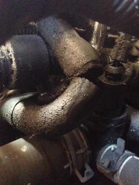

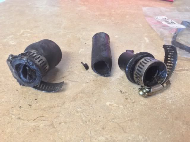

So I finally get around to doing the CTS because my last tank was worse for MPGs and I had a hard time starting it when we had some low temperature the other day. Forgot to mention that I had been smelling something fumey at stops. Found out what that was. Someone did some quality repairs on the PCV crap.
Merely glancing at it turned into this really fast:
This has been repaired. The thing that bothers me about it is that someone probably got a bill for that crap. Going to do a fuel filter next and check over some more basic and low cost stuff.

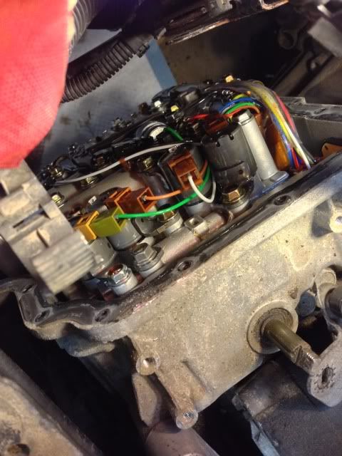

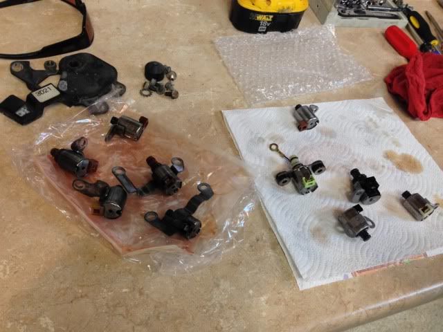

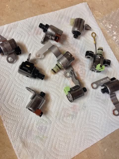

A reel pain in the ass when factoring in a learning curve, but........ I got reverse and the other shifting problems fixed!!!!!! :unibrow:
9 New shift solenoids installed. Was a gamble, and I won.
You need this :thumbsup:
Next time you back out of a parking spot or your drive way, be thankful.
