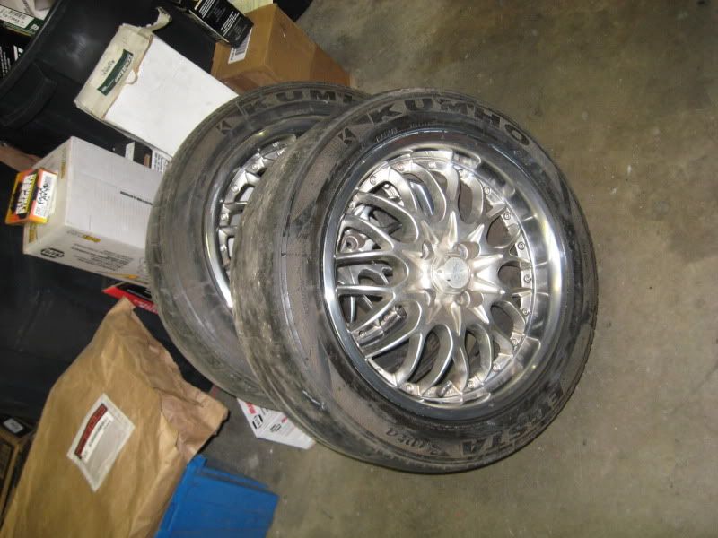

i picked up a set of konig imagines some time back, the other day i decided to start restoring them

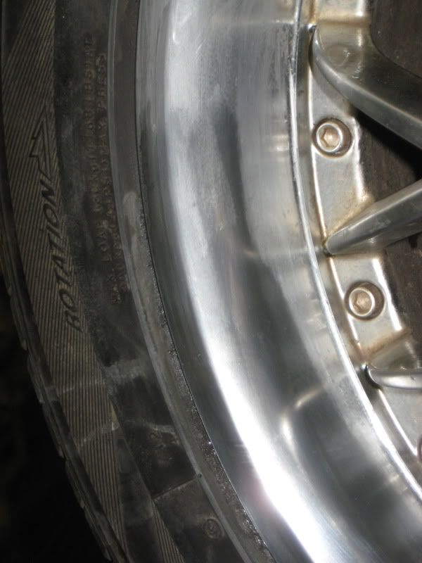

the wheels i started with

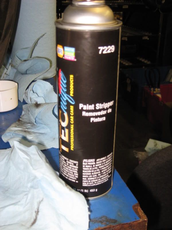

the paint stripper i chose
stripper applied

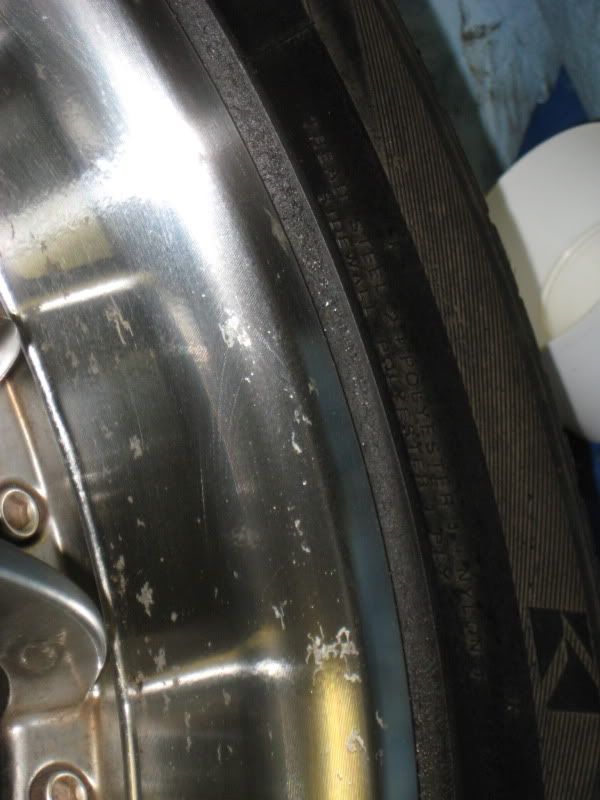

after stripper

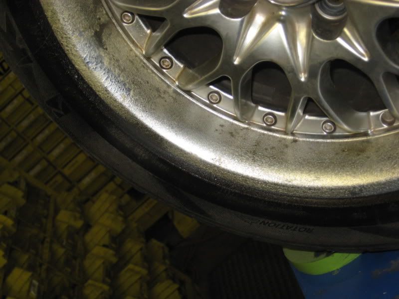

start with the sanding (this depends on how bad the wheels were i started with 1000 on 3 of them and 400 on the last one)

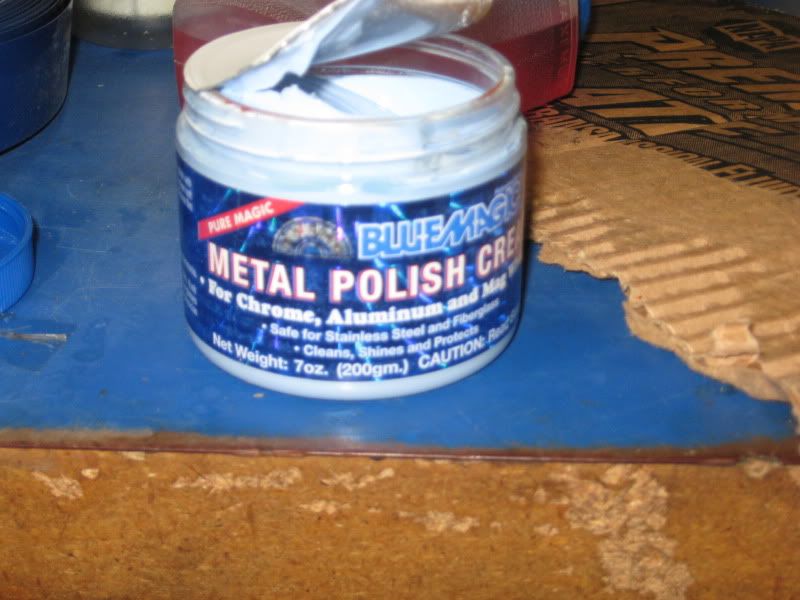

then apply the polish of your choice. i like blue magic. but if its in the budget try and get some POR 15 artisn metal polish it rocks!
