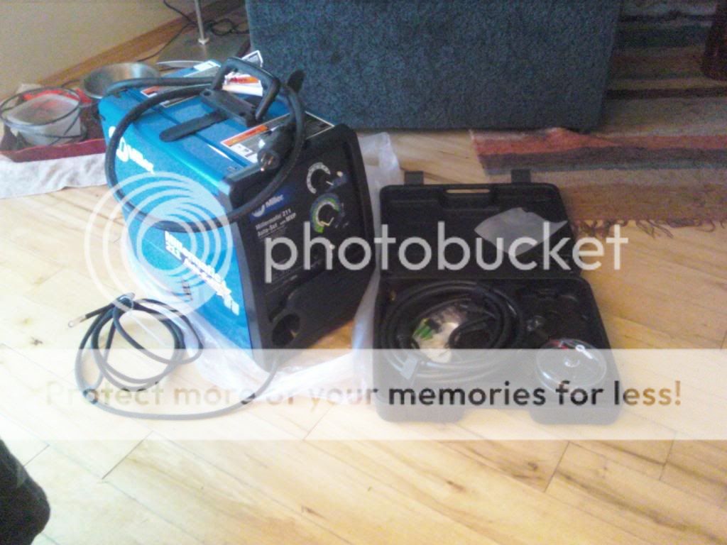

Postby Mrbubblehead on Mar Wed 27, 2013 8:13 pm
Off subject, I just got my welder today. Miller 211 with the Spoolmate 100(for aluminum). Now I need a cart, gas, and 230V wired in the garage. So excited, and I might just not be able to fight it..

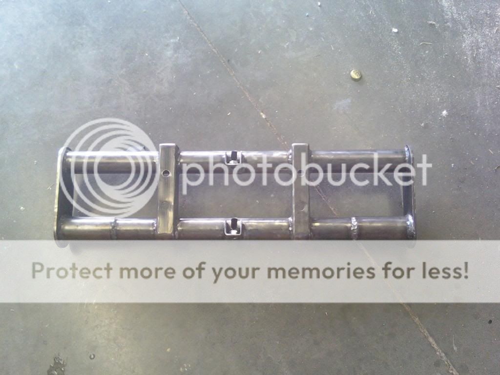

Postby Mrbubblehead on Apr Mon 15, 2013 5:31 am
I didn't get much done this weekend to the car. But I did run 230V into the garage so I could power up that welder. Since I powered it up I decided to fix up that narrowed beam that came with the car. I cut the shock towers apart, measured, and re welded the whole thing. I cut the shock towers off too. Wire wheeled the beam and thats about it.

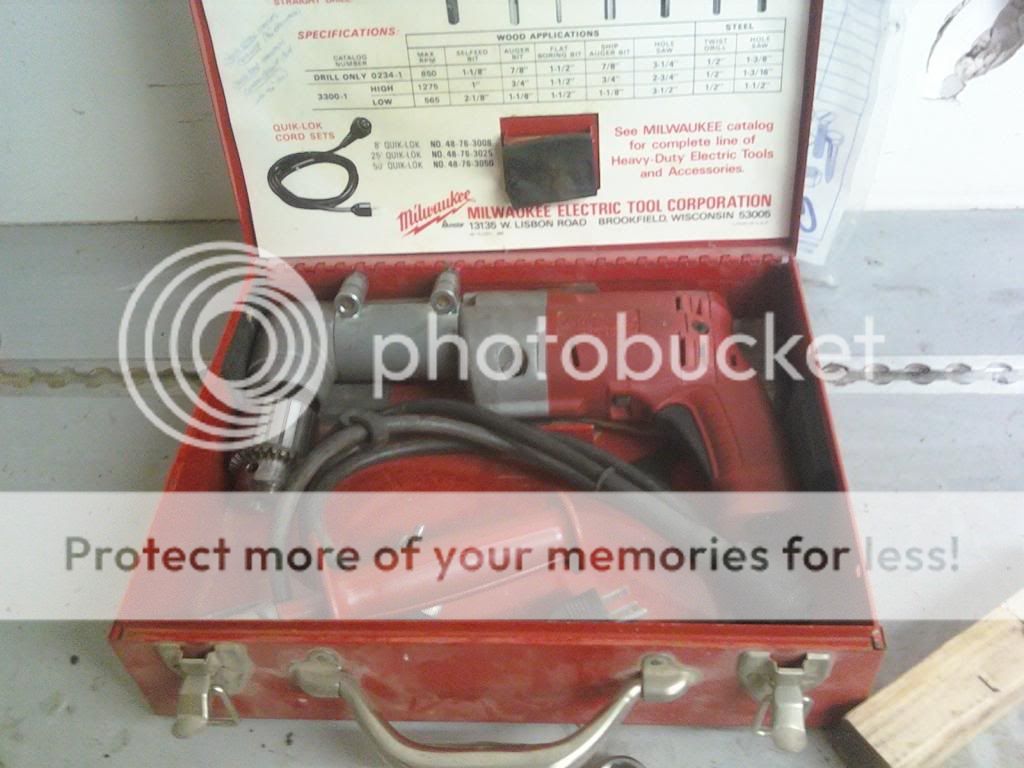

Postby choptopvolksrod on Apr Sun 21, 2013 10:57 pm
that happened on one of my cars. I was going to drill the bolt out and helicoil it but I didn't have a helicoil that big. I just ran to ace and got a really long bolt and a nut and drilled the old one out and put the bolt all the way through with the nut on back. good thing is though if you go that route you can always go back and helicoil it later
choptopvolksrod
Posts: 324
Re: The 66
Postby Mrbubblehead on Apr Sat 27, 2013 7:17 am
I went the drill out, longer through bolt route. That sucked, about 1" of the bolt was broken off in it. It took forever. Luckily last year my dad gave me his old Milwaukee angle drill (Made in USA :unibrow: ), there isn't much room down there. The front beam is bolted in got the brake backing plates on. I'm going to finish off the front end Sunday. Next week the motor and tranny come out. Also ordered a new stereo. I'm probably going to leave it at the height it is now and not slam it back down. It rides much smoother and wont have to worry about the rear end as much. Plus I'll be able to drive it down the streets where the pan used to just drag because of uneven pavement.
