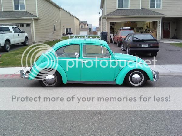

Post by Mrbubblehead » Apr Mon 16, 2012 6:20 pm
I'm having to many issues with the rear end, with the car being as low as it is. Axle nuts coming loose and drum splines wearing out. I've been talkin to folk about it and the word is that keeping a swing axle that low will always have problems. The car will get lifted a little to see if it helps. 1.5" rear and 1" front. :(

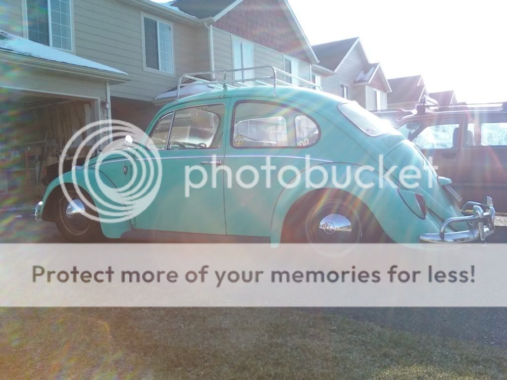

Post by Mrbubblehead » Apr Wed 25, 2012 8:02 pm
Here is the height the bug will be at for this summer. The axle splines are not looking so hot. One of the bearings is already a little rough from the axle angle not giving it lubrication. Next year i hope to throw in a new tranny, axles, and whatever else it needs, then drop it a little lower(not as low as it was, but lower than it is now).
Re: The 66
Post by padroB5 » Apr Wed 25, 2012 10:55 pm
i like it at that hight right there! still have enought graoun clearan to get around MT lol
