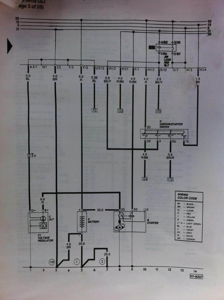

Postby idubse7en on May Wed 21, 2014 7:18 pm
This is the circuit, the load relay. The ignition wire comes into the relay and out to the starter. I can jump the relay circuit with a wire, but, with the actual relay it will not start.

Postby MT-Getto on May Fri 23, 2014 5:34 pm
You have a seatbelt switch on the starter? Mine required the shoulder belt connected to start the car

Postby idubse7en on May Mon 26, 2014 8:09 pm
Ah yes, the shoulder belt., what a fantastic safety feature… Damn.
Well thanks Getto saved me from wasting any more time looking through wires.
