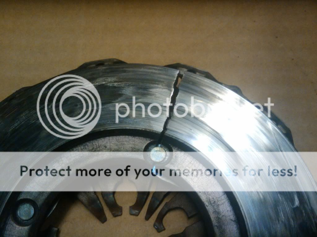

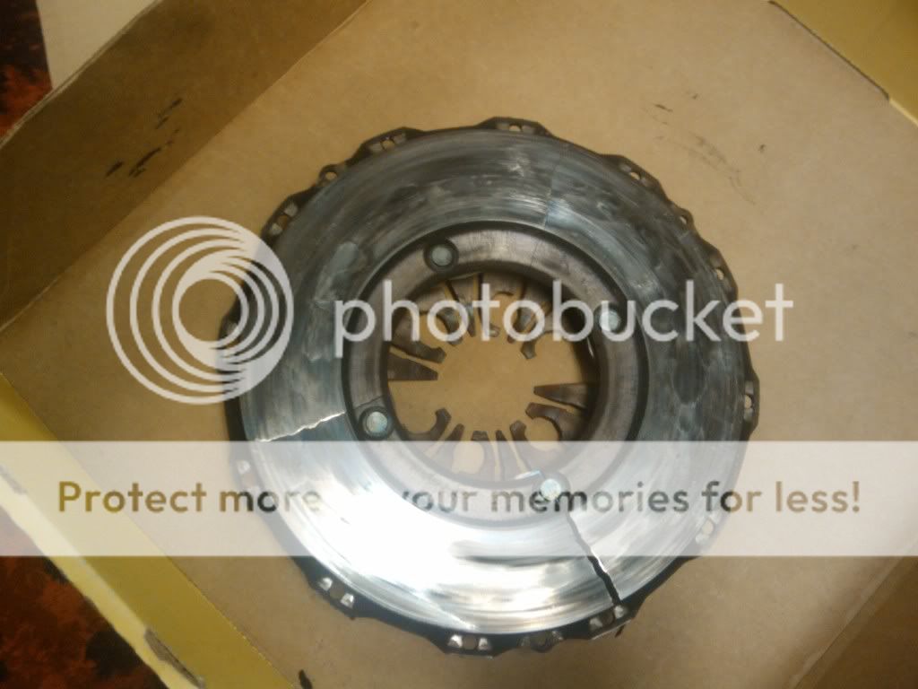

SO... the clutch has been fixed... and it was just miles from exploding. I kept the original clutch as a souvaneer.. pix to follow shortly.

Postby AKRadar on Apr Thu 14, 2011 2:10 pm
I am sure you have seen these... but here you go:<br>

Postby kompressorgolf on Apr Thu 14, 2011 4:14 pm
DAMN! done it right!
